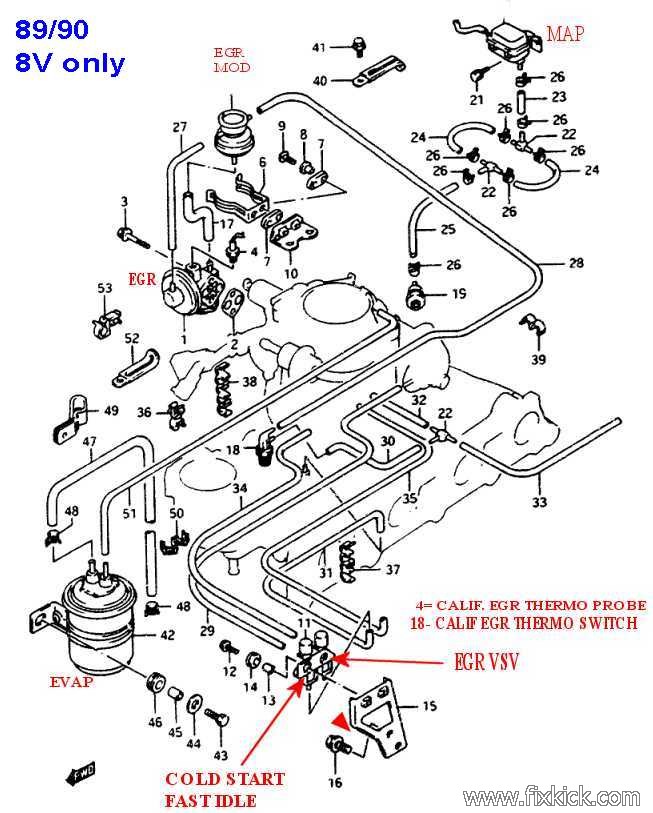

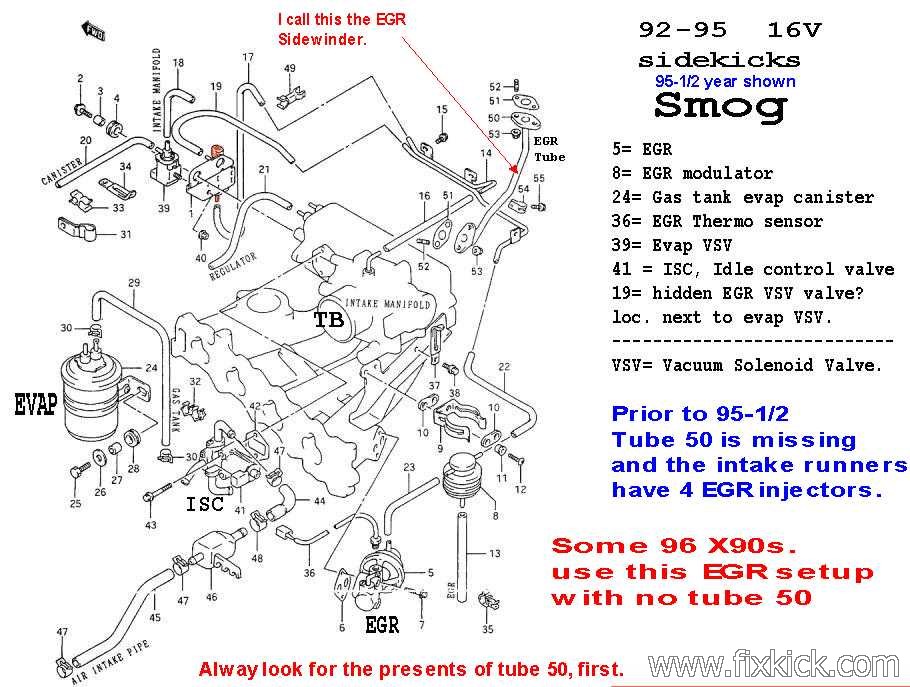

Use a "T" fitting to conduct all tests.  (however the EVAP line DIRECT, can be used on all 91-98 motors, pulled)  (before VSV at the plenum)
Attach the gauge to the  on G16A 89/90   to the Distributor vacuum line #33 , the G16A 92-95  EVAP VSV input nipple #44 here
and all G16B (16v mpi) line #18
