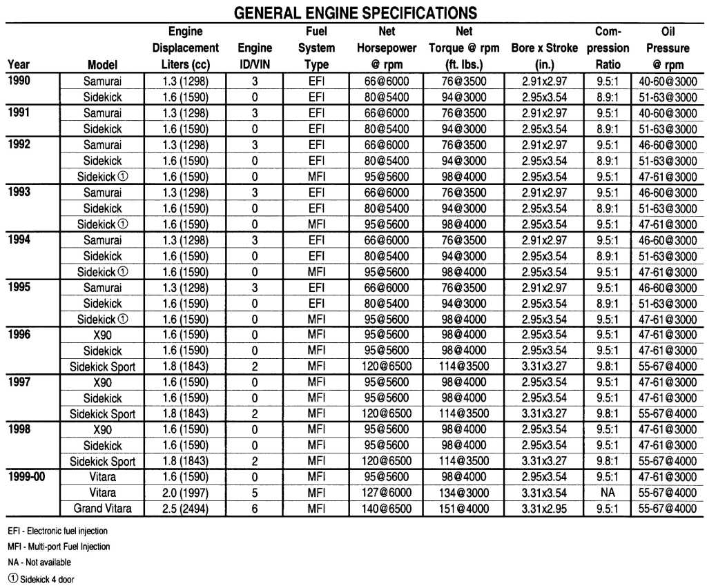

What is a Gallon?, seems an easy question and is, inside confines of USA.
The USA EPA 1995 spec MPG , is 19 to 30 MPG]US], << see arrows! in linked photo?, with E0 fuel (gasoline pure) E10 a tad less, a 1/2 mpg?)
My 2 Dr.-5speed, does 28 MPG one E10 fuel. (open road !) 60MPH. (unloaded and flat ground)
The same car gets 34 Miles per Imperial gallon[UK]. 20% more due to the large gallon size.  Even a tad more on E0 fuel
E0 is pure gasoline (octane) E10 is 10% Ethanal.
Our engines (EFI) are not tuned to get good Ethanol mileage.
The metric fuel economy is  8.4Liter /100km

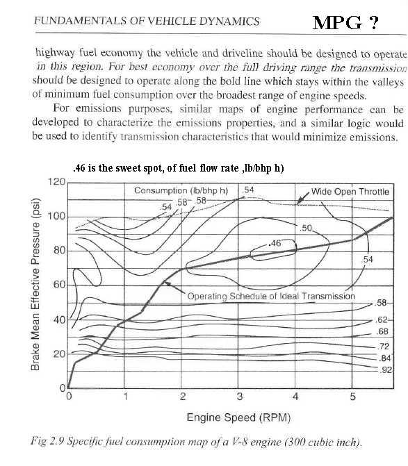

What does MPG look  like?, well , this plot was done on my 96 with a full OBD2 scan tool and Laptop.  See the instantaneous MPG?  See the complexity?
The above car is a 5speed  2door 4wd and has a 95hp 16v motor that produces max. torque at 4000 RPM.  I get 29MPG.
Other motors have different sweet spots, due to different motors and transmissions ,etc.
Best practice, is to buy or make an MPG gauge (#11) and discover your cars MPG sweet spot in each gear, and learn to drive all over again,  For Sure.
A cheaper way is to make a closed loop LED, for the dash, my MPG gauges has one. Drive and keep this simple light glowing and MPG will happen.
