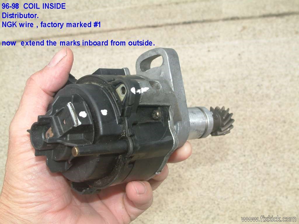

i think gorkyb dizzy gear, some one put it on 180 deg off, it has 13 teeth and is not symmetrical. must be marked before take off that locking pin
http://www.fixkick.com/IGN_timing/slides...b1w%29.jpg
note rotor tip, and gear teeth and pin relation ships. here. and the china rotor syndrome that fits on 3 ways, add those 3 and the 2 pin gear ways, and
huge ways to mess up. (the gear on the end has a relation ship to the hidden, hall sensor tooth, and most not be violated.)
in all cases of wrong fitment above line, spark is hot and good., correct out of coil but not to the spark plugs.(distribution errors)
