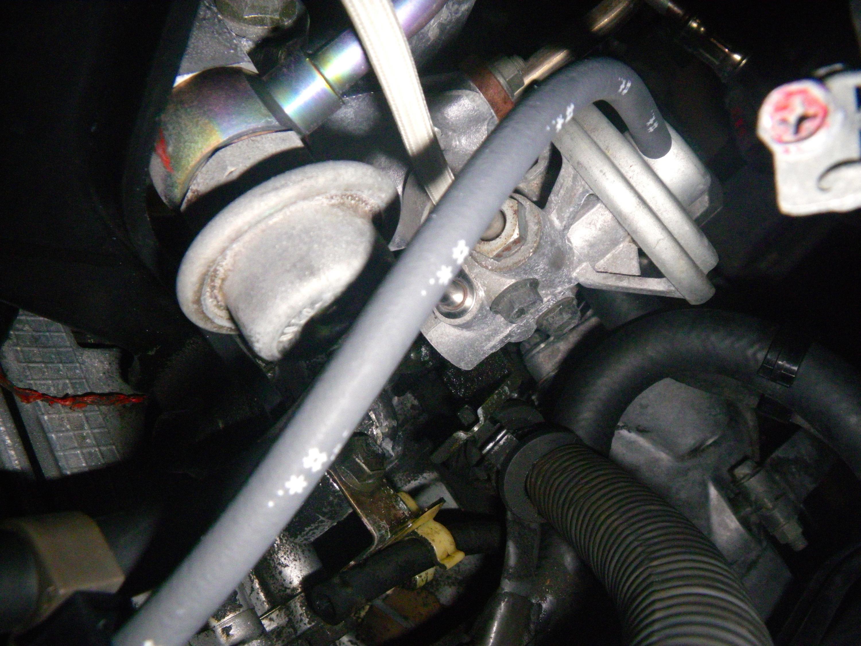

Here is a pic of the left side of my engine....I think I have that sidewinder tube.
http://www.fixkick.com/bbs2/Suzuki-bbs/g...30_09.jpeg

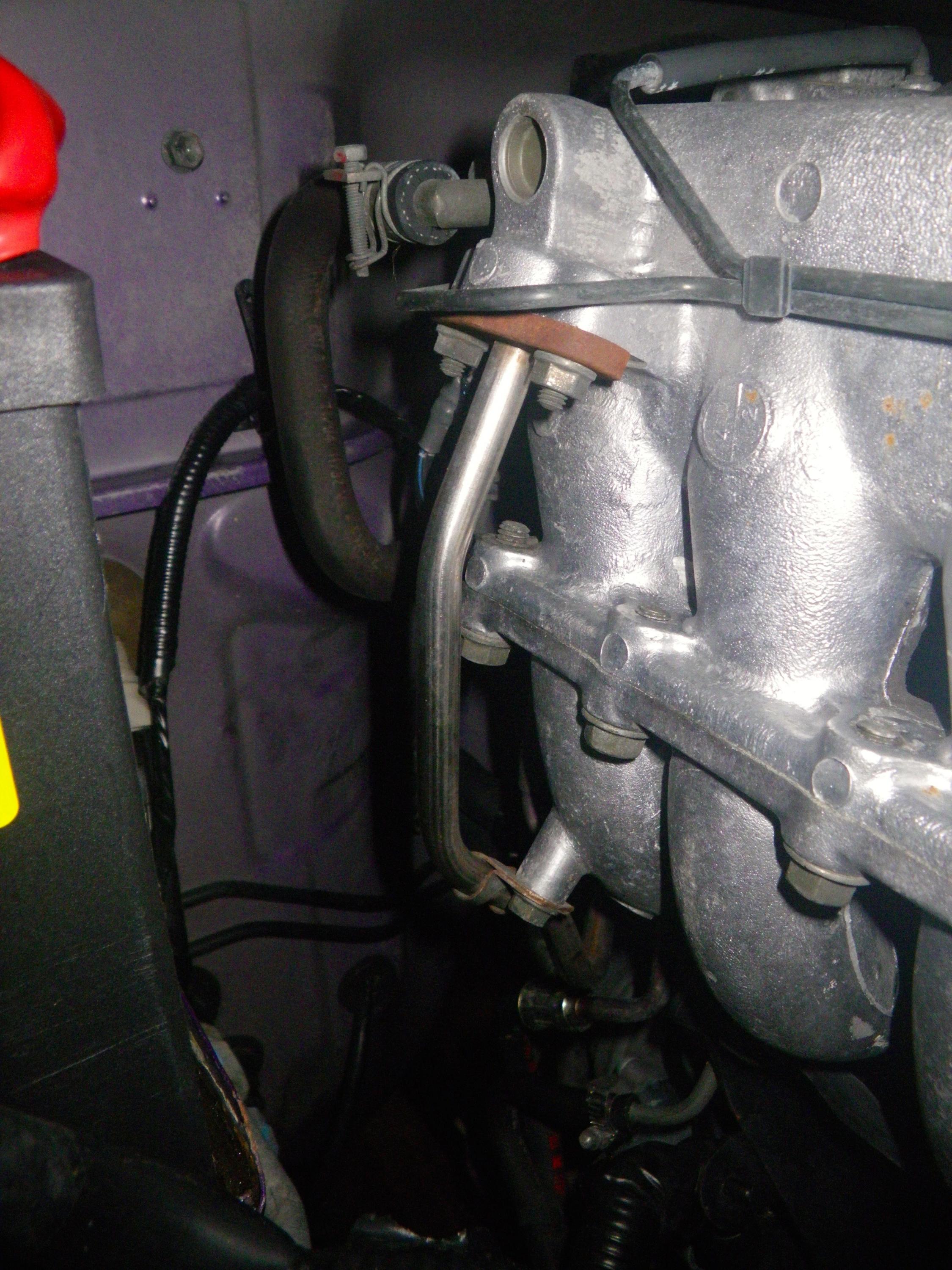

Here is a pic of the back....
http://www.fixkick.com/bbs2/Suzuki-bbs/g...37_37.jpeg
Are you saying that the tube is probably blocked? Should I just take the sidewinder off of there and clean it?

that is the new 1995, the sidewinder, no quad egr ports,
gooooood
does it stall when you push the EGR main diaphragm.
does it stall with vacuum applied to the EGR main nipple?

Posts: 6,078
the exh path is blocked, see links here.
id do the least work, its a pain to do end to end, a lost week end, not worth it.
but we can find it so very easy with sidewinder
lets pretend its easy fail. do those first , then a bark test, at upto 3 bark tests max.
what id do is remove the top of side tube, sst sidewinder. remove sst tube center clamp first. ,
remove the pipe, and start engine and repeat the push diaphragm by hand test. does the tube bark?
up top. see it here?
http://www.fixkick.com/sensors/EGR/97-cl...index.html
yes, the the 11mm hole in the TB is plugged, see photo 1 here
no bark ? take off the tube totally dont lose the 2 sst gaskets, reused them for life time.
if it dont bark with the tube all off the valve is clogged.
its harder work now, , pen oil the threads and remove the 6mm screws gently buy rocking them. to not break the, 7ft'/lbs is all they can take.
remove the EGR main. i put a cork in the intake side of the eGR base. and start engine. does the other port bark,? yes/no.
if yes then the EGR main, is clogged, but id bet you already noticed that when removed.
I work high to low, saving work time..
http://www.fixkick.com/EGR-horror2.html
yours is half gen 2 and 3
but gen 3 has side winder
http://www.fixkick.com/EGR-Gen3.html
