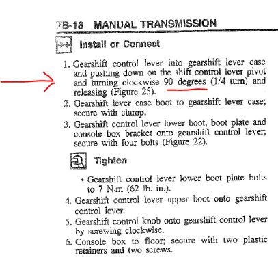

step one is drop 27 into hole 30 (geased up) #27 needs to be new, and is sold only by suzuki for about $5
then 19 part next
2x 36 screws half installed,
the top cup is a twist lock cup, some can force down, and twist lock it
I find pushing it down and inserting 2x 36 screws while holding down is easier.
if he spring is not broken IT IS OK.
seen here PDF FSM, page 18, 7B18, install... steps. chapter 7B covers this tranny, see photo below excerpted

When installing the new shifter bushing (part 27), do I just drop it in? yes,
Or do I have to install it on the ball end of the shifter stick? (no)

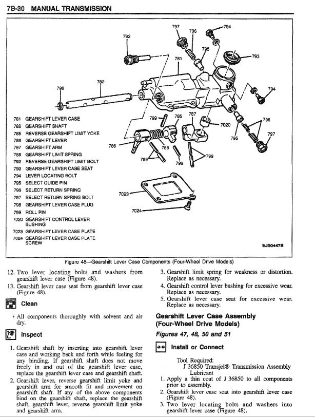

the manual tells you what to do. and is assem lube, all that , there, all rails and all extension rails lubed, and the #27 plastic too.

here is the lube, used
https://www.handsontools.com/Kent-Moore-...13139.html
id say any assembly lube for trans is ok,
the maker calls out a specific lube, that is unknown to them so they guess GL4 , on page 30 of the manual, j36850 transmission assembly lube.

7: Or hold down the CUP, against that strong spring and remove both #36 screws. Bam its off. Do not lose those 2 special screws #36
here is my step 7, and how to do it in reverse depends on how strong your hands are, i found pushing it down and inserting the 2 screws the most easy.
but it is CUP twist locking cap, for sure. you can see the twist log cut outs on the cap easy, and is the biggest hint those.

new 27 plastic, it fits tight and ends the sloppy shifts in all cases this is it . fails easy. for sure not lubed.
and twist lock CUP down with #36 screws, loose turn 90deg, CW to lock it down. per manual.
or push it down such that the slots align with #36 holes. and then insert both screws 1 at a time. (i found this more easy.)
