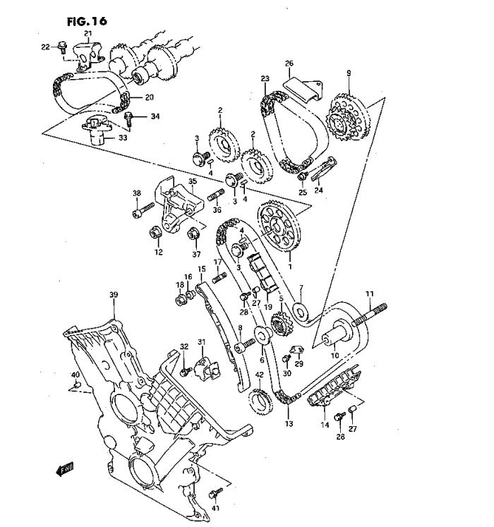

If any topic is infinite, this would be it, machines, and for sure cars, can make noises of the most strange and difficult to discover, and moving only, noises , tops this list. What won't work?, Answer, Guessing ! As always, Scotty does it best ! (he covers many sources of noise or bad vibrations ) Finding the LOCATION first, is a top priority. Noise or felt vibrations, felt where?, the steering, the hand no setting on the shifter knob, the foot pedals, the seat of pants? Is also key. This page is all about not guessing. I also try to cover not just old 1.6L engines, but newer cars too, (HLA engines, DOHC). "Double overhead cam shafts" All ASE mechanics are trained, to first read the TSB's of the vehicle in question. ( read them all but do look for things that cause noise, or early failures that make noise) TSB = Technial Service Bulletins (Suzuki service issues) One popular TSB is TS-01-10-10265 (all Suzuki cars with brakes) or the TS-12-01074 how to get the DOHC engine timing cover to stop leaking . Abnormal noise ,can come from many places, some are very serious to your safety ,or the life of the object complaining so load. Engine: Belts, accessories, the Brakes:Suspension:Tires:Wheels, transmission, Prop shaft, CV joints, Universal joints, Shocks, Struts, or just road debris stuck under car. Keep in mind a noise can just be a cracked Catalyst converter shield, mostly harmless , they can rattle or buzz. I make them buzz with the throttle then jam a stick up there and bingo silence. In most cases noises are a very bad sign, it's the sound of a part asking for help. I personally don't drive cars that do that, until such time it is found to be harmless noises. The first rule is to try hard to make the noise happen parked, if you can do that, you are lucky, as moving fast noises are very hard to find ,with out a sonic ear tool. Inside car noise, out side, under dash? the location is critical to the solution. The brakes (God forbid) tire noise (bulges?), Overwhelming? The first thing to do, is inspect car for loose parts and tire damages, the brakes, if the noise source is not obvious. (everywhere top , bottom of car). See man handling comments below. Try hard to make that noise, not moving. Try real hard, even with brakes set, chocked wheels and in DRIVE. and at same time spin the steering wheel full left and right. BINGO? If the engine, makes noise, don't drive car until you find the cause. (does the engine have oil inside? up to the Dipstick mark, same with A/T (RTM read the operators guide , and is free to get) If the brakes make noise, they are bad, many cars , have front shoe noise makers telling you the pads are END OF LIFE. check the pads. (best is to look every 10,000 miles at pads/shoe linings.) If you lightly press the brake pedal moving slowly, if they squeal with thick pads. and the markers are not hitting the rotor, this is normal, you can buy what I call PAD glue to arrest this normal squeal. If you hit road hazards, the object can hit the brake backing plate and bends it, bingo noise. Inspections of same , finds the damage easy. My first private Suzuki 91 Sidekick, the left lower Suspension "A" arm the lower bolt was just about to fall out.(nut long missing) My inspection found this in minutes. LOOK under car, LOOK 2 times. Jack up each wheel/tire and spin it and feel the bearings, and listen, and use a lever on the tire, up and down and side to side, looking for excessive play. If you don't understand what excessive means, then get a PRO to look at your car. The top instrument for finding noise is your , stereoscopic ears, you can sense the direction, use that natural, way to find what section of the vehicle is making noise. (inside car, or outside?, is first) Location is first, find the LOCATION. (use a helper, or use a remote electronic stethoscope to find the source, they cost only $50 today) No person, on the internet can use their stereoscopic ears, not now , not ever. This topic is a hands on deal, always. You an also buy 50 cents of rubber tubing, 1/4" Id( 5-6mm) and put one end of this tube in your ear and move the other end in many places to find noise.
