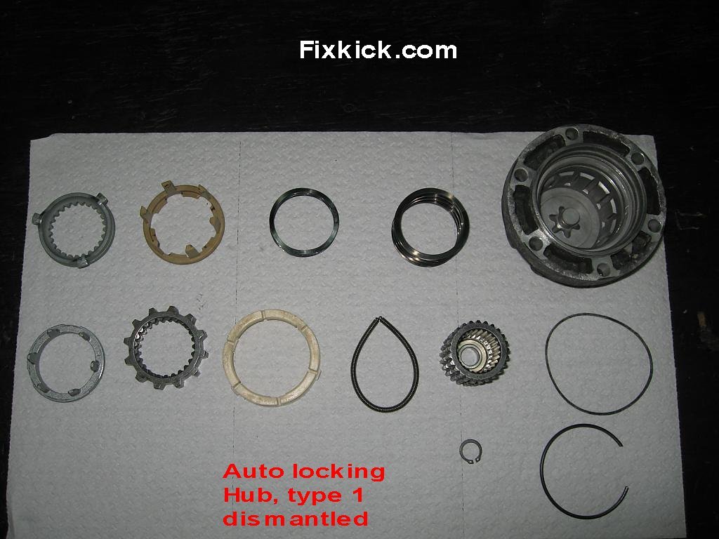

Remove the hubs with the outside 6 bolts.
The FSM says, not servicable.  well....  not really true...
Look for broken parts , clean it and look again ? , if anything is  broken, they can't be repaired.  (unless you  get wrecking yard spare  parts)

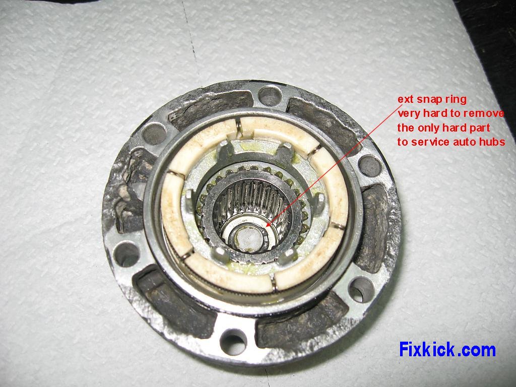

Remove the inside snap ring ( this will be a harrowing experience  ,even with the 6 snap ring tools that I have in tool box)
Now take it apart and cleang it .
Put it back together with a light coat of marine GP grease ( is use a 1/2" paint brush ).
Than I  put back that pesky snap ring.
