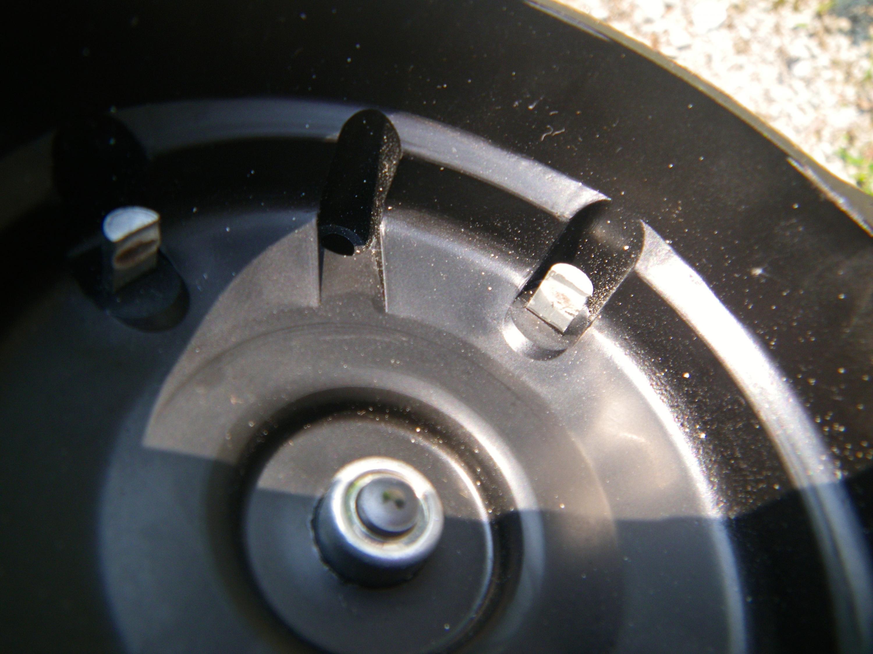

Also, here is a shot of the dizzy cap. You can see the corrosion on the posts. Top left one is really bad. I'm glad I'm changing all this stuff.

the corrosion is all very normal
the HV arcing causes Normal metal migration, it causes the alum post alum. atoms to actually fly off the post, (the first atomic bomb was made using just this magic)
(HV , Uranium enrichment process)"read book called Manhattan project, wow" i just read both, on my NOOK. dang good read....
the spark plugs do the same thing , ever seen the tips go round? same deal and the gap widen in time ,same its called a plasma.
electrons + ionized atoms. flying in space.
I have 2 friends dead from plasma. (doing HV , vault tests, and it flashed over, RIP ) "HV Electricians" 25kv.
What is bad, is the plastic dirty or carbon tracking, very very bad.
the dirt invites the latter to happen.
