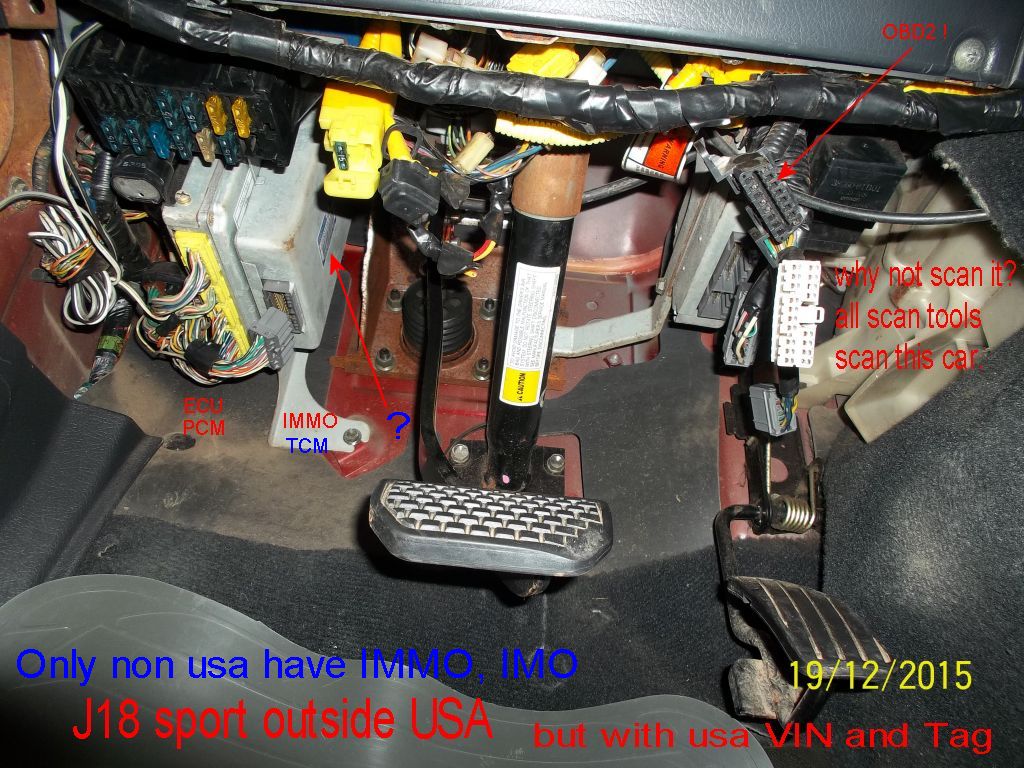

the is TCM, but outside usa can be IMMO (immobilizer option) I vote TCM but you never posted that sticker number?
nice photo too.
not only that, i see the OBD2 16pin connector top right. you cant find that? it yells OBD2, scan me..!!!!!
they yellow connectors are air bags, do not mess with those, or get hurt,, read the manual on air bags yet, that be FIRST !!!
photo was 56 inches wide , so shrunk it to web size 1020pixles.
now seen in gallery.
Dear Fixkick,
I am sending you the pictures under the dash of driver’s side.
The first one shows both ECM (why are they double?) and PCM (two couplers-one big and one small) couplers are removed, right?

In post # 3, the 35 is TCM (it is on the right, not the left?). So in my picture it is under the OBD2 with two couplers you have marked it, right? Or it is on the left next to ECM?
I will make another photo of the P/N.

both boxes have stickers, and both have a Suzuki partnumber. and clearly tells me what it is...
the left box is always the ECU,
the one next to it is TCM.
the photo is clearly marked. no?
in the photo I marked box 2 ;why is it unplugged;, its the TCM
38880-77e21
the prefix , means TCM 38880,
the Suffix , means J18 car, version (not G16)
why even look, at boxes. it's of no use at all, unless it was found unplugged, as it clearly is in the above photo.

Come back to ECU/PCM and TCM issue!
What's about the one with two couplers on the right knee directly under your mark OBD2? I already used the flash light and I do not see any sticker on it both side. And what's about the white connector on the right? what are they, then?

the factory boxes are all marked, (takes looking on both sides, all sides, 6 sides.. possible.)
the drawing i sent is real. it matches your car. (above dash photo is correct.!)
it shows cruise or ABS. id 13 or 55?
the boxes are all marked.
every one,. the part number is the proof of what the box, does, post your stickers and i can look them all up.

i recommend this , because if its easy of use. 1 part, 1 tool, plug it in and scan. easy simple and problems free. (unlike wifi, or blue tooth and USB laptops)
why not JEGS. shows Cambodia. as a ship too address. I buy from them all the time..
here is one tool 3140. ( they make many versions)
http://www.jegs.com/i/INNOVA/336/3040/10...oreDetails
this faq page covers a key questions.
Yes. The only Innova tools that offer Live Data functionality are the 3040, 3130, 3140, and 3160 Scan Tools.
if buying a scan tool, this is a key features, so you can watch sensors live.
these tools do not support, (innova, suzuki ABS or Air bags, just the PCM/TCM/ECU)
https://www.google.com/search?q=innova+3...8&oe=utf-8
or the 3040
click 3040 in this search box.
http://www.innova.com/en-US/Support/FAQs
shows what it can do.... FAQ.... it does lots.
keep in mind, if the transmission is slipping
that the scan tool will show speed sensor, PERFORMANCE codes.
a transmssion shop, knows this.
he : (in a nut shell)
road tests the car, and drivers aggressively to FEEL slip
then disconnects the tcm and shifts manually to see if trans, slips.. (this is covered in FSM book, all this.)
he see that each of the shift lever position, will activate the correct gear show in the FSM and on my main TCM page. (skips 3rd gear) as does TCM skip 3rd gear in TCM limphome mode.
he
does the stall tests. (shows weak engine, or shows, a slipping trans)
then
he does the line pressure tests.(per FSM using his gauges)
all after a full flush (ATF) and new filter, sure. (if AFT was not black and tar like.... dip stick tests, and smell of burnt ATF, he might in fact say, dont do a flush for CAUSE)
the scan tool is just one , part of all this. it's not the "computers know all tell all thing,, nor computers, saying, clutch plate 3 slips)
The scan tool is but one step in a process of steps. (as your pro transmission shop this....)
the G16 transmission is same. (TCM is tiny bit different , it is for sure different because of the extra 45hp engine power, has new shift tables. inside.)
this chapter covers all tests..... this is what your shop would do ,should do....
http://www.acksfaq.com/96-FSM-v1-7A-pdf.htm
03-72LE trans is your trans.
skip words about 3L30 (3speed)
