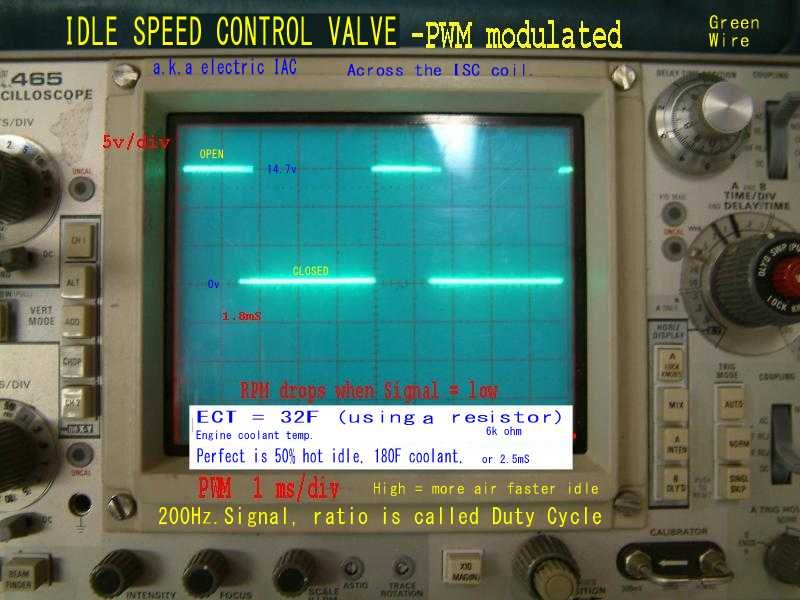

Image 35 of 47
This is the 200 hz modulation of the ISC. 50% is perfect. 5mS period, 2.5mS pulse (hot engine,) if wrong use the bleed screw to set it correctly. The ECU controls RPM , only you can set duty cycle and not have air leaks making the ISC go NUTS.
